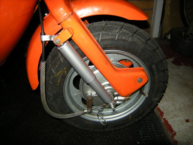

Post  itsjoeyfontane on Mon Sep 01, 2014 4:19 pm
..series 3 spings are too hard as they are made to carry heavier weight and will bounce you off the road...
weld the best quality series 3 damper mount brackets to the forks
drill n tap hub spindle for bottom damper stud
for best suspension set up targa line dampers or for budget the best standard Italian dampers...
the targa dampers allow me yo ride bumpy roads at full speed 50+ [wow] which would be imposable without!

Post  Snails on Tue Sep 02, 2014 3:16 am
Are the targa one's the bottom ones Joey?
How much do they cost? look very trick Smile

Post  Thackers on Tue Sep 02, 2014 4:54 am
Targa front dampers are very trick especially on a Vega, cost a lot of money too. Joey's front end is well thought out and engineered, looks like tubeless rims so must have full size tyres. I bet if they were making them today that is exactly how they would be, I bet it holds the road great.

Post  Bobbylad on Tue Sep 02, 2014 5:20 am
That does look very good!

Post  shand on Tue Sep 02, 2014 10:34 am
Cheers for the reply Joey, how deep do you drill the front axle, would 12mm be enough

Post  itsjoeyfontane on Thu Sep 04, 2014 3:35 pm
..thanks for your appreciation...
..get some series three damper mount studs and drill to suit...

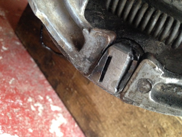

Post  itsjoeyfontane on Fri Sep 05, 2014 3:52 pm
..got the rear sunny hub but you need to modify the cam..its a bit like the difference between LI and GP..Wack advised and modifide mine..and i found it needed to be a bit thicker..
Ordered the rear damper..can't wait to get it on...thanks

Post  gc on Tue Sep 09, 2014 7:54 am
Are you using J range brake shoes Joey? If your using the Vega ones it'll be a mis-match hence the cam issue. Could be wrong but may be a point to consider.

Post  itsjoeyfontane on Tue Sep 09, 2014 2:55 pm
..j shoes i'm sure..as vega ones are narrow etc..anyhow here's a picture..works, a bit rough but ground n filed 'til hub fitted...works well...
