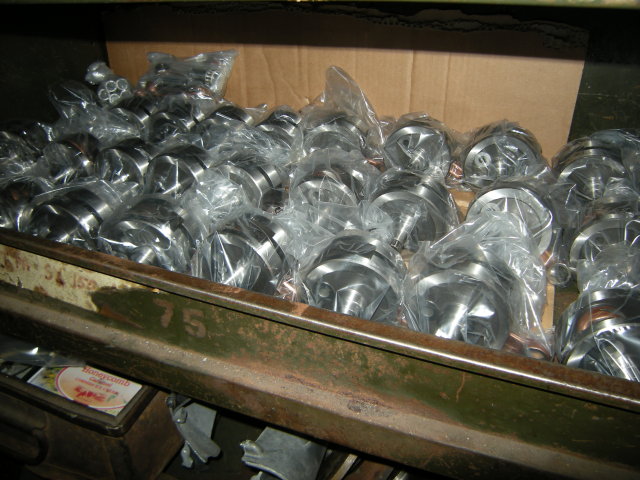

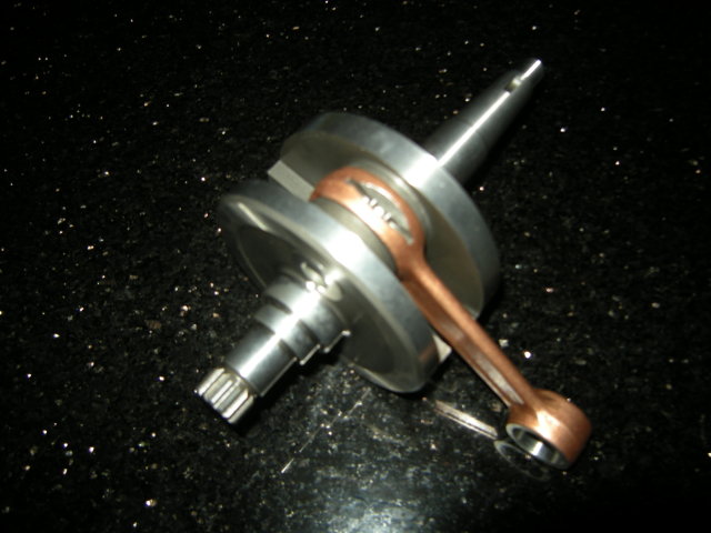

hey,got myself a new 75cc crank from Armandos today...it's top quality with 'v'd big end oil slot,oil holes in little end and little end is bigger... Very Happy

little end is bigger? still able to fit standard gudgeon pin?
how much are they?

...hey yes..bigger rod end,bigger little end bearing,standard pin....+++! someone will be along soon with their micrometer...LOL.....

hi, I just bought one of these cranks but its slightly different to my old one. the old one has a small taper against the web unlike the new one which has the two slots . can I still use the 3 piece bearing and mag housing.cheers.

boozy, the crank and 3 part bearing you have are mis matched.
the crank with the taper is for a ball bearing type bearing, the 3 part roller bearing is for use on the non tapered cranks, the mag flange bearings are not interchangeable either, again crank specific.

cheers daz, just had another look and scratch of the head.you,re right it looks like the previous owner had fitted the 3 piece bearing to a roller bearing crank, no wonder it was rumbling its tits off when I started it. got all the correct bits now for the rebuild. what size is the woodruff key supposed to be. cheers.
