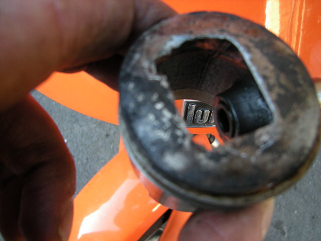

hole
Post  modgod on Thu Apr 19, 2012 11:03 am
by the way thats a nasty hole youve got there Sad
